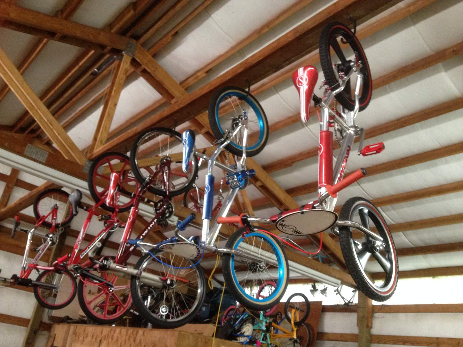

    Mark S https://s3.amazonaws.com/uploads.bmxmuseum.com/user-images/93155/image5822534611.jpg

    I have a blue Anno Pro Stock 1 with a non ram-air seat stay tube, it's down from the rafters so I'll get back to you with the serial.
