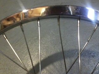

hoops with eyelits are better for certain hubs or lacing patterns, like superlace hubs, for example, . the spokes can angle much more on a hoop with an eyelit.
http://i1243.photobucket.com/albums/gg548/caleb_k31/others%20restorations/001_zpscff96a2c.jpg
http://i1243.photobucket.com/albums/gg548/caleb_k31/others%20restorations/002_zps942bb711.jpg
if the nipple has no eyelit to rest in it can end up looking like this with these hoops, because the spokes angle so much.
http://i1243.photobucket.com/albums/gg548/caleb_k31/others%20restorations/085_zpsc9c6a81f.jpg

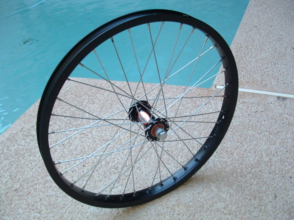

Just followed the building tech and come out with these, what you think?
http://i173.photobucket.com/albums/w60/Croydon4wd/31052008001.jpg
92 Robinson Pro

looks great, what is it?

96 Diamondback venom,  $25au purple flip flop hubs (pair) from ebay, $40 black alloys (pair) and black spokes with chrome nipples
looks great on a matt black frame. imoa

#25 2008-08-27 1:23am
flovalflown
From: Pomona, CA.
Registered: 2006-11-11
Posts: 484
Re: complete WHEEL BUILDING instructions
thanks alot caleb, my first set of wheels, dont know what kind of loops , but the hubs are gt mohawks. quickie polish job.
