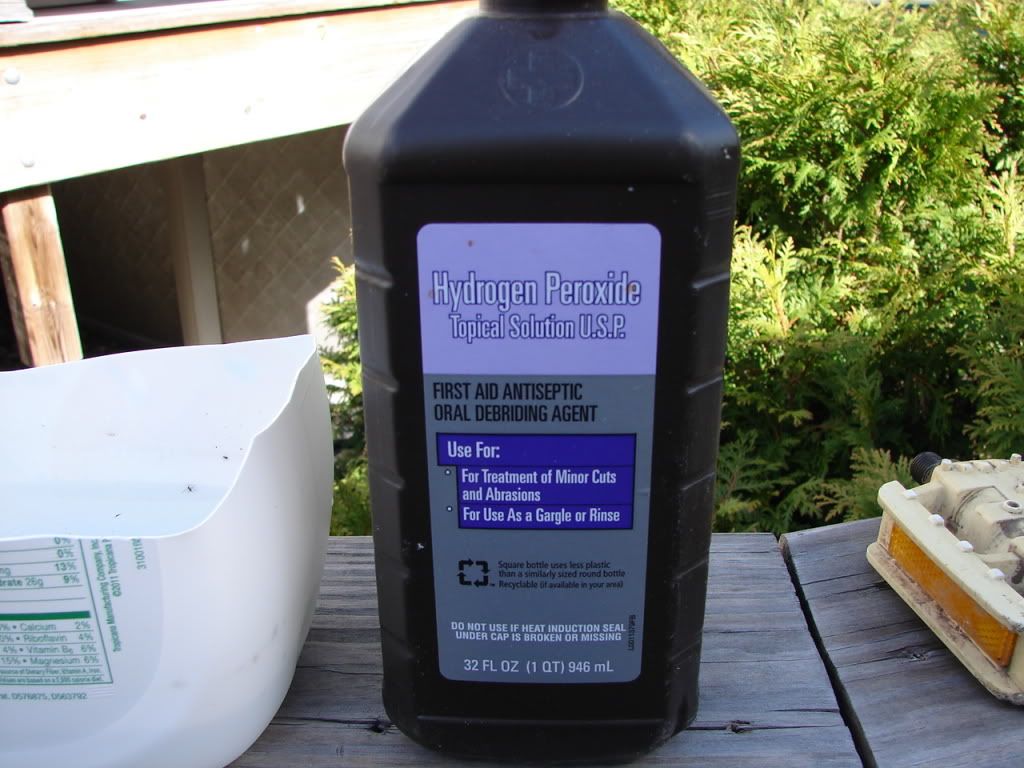

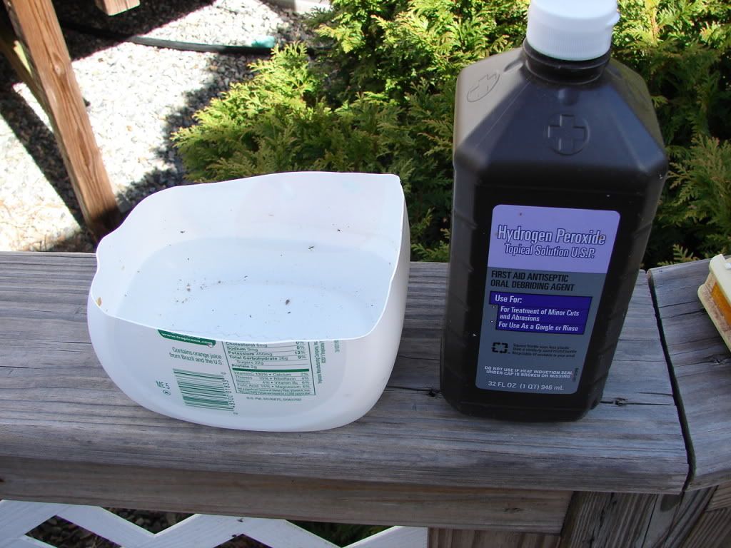

Before I tried it on my nicer ones on my 88 Pro Compe, I got an extra set of these HTI-851 pedals from Caleb to try the "hydrogen peroxide in the sun" soak that I found (of all places) on a computer geek website. The geeks were trying to whiten an old plastic PC tower and one recommended soaking it in hydrogen peroxide and leaving it out in the sun. Well, being a BMX geek, I had to try it!
Here is a pic of my reservoir, it is the bottom of a Tropicana OJ jug (don't mind the bugs), and the 32 oz bottle of Hydrogen Peroxide sloution from Wal-Mart.
http://i962.photobucket.com/albums/ae106/demian06/DSC09928.jpg
http://i962.photobucket.com/albums/ae106/demian06/DSC09929.jpg

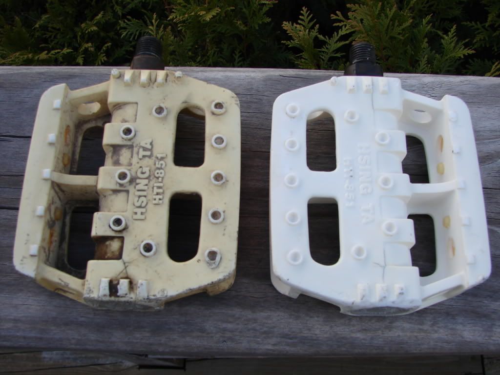

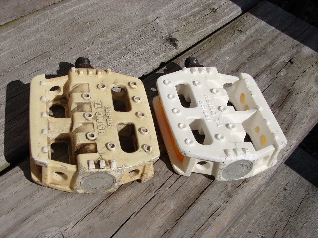

I cleaned one pedal with simple green and a toothbrush first, then put it in the peroxide soak till it was completely submerged. I took the container out to my back deck last Sunday, I flipped it every day, and now its Thursday (5 day soak) and here are the results (guess which one was soaked lol):
outdoor pic in the shade:
http://i962.photobucket.com/albums/ae106/demian06/DSC09930.jpg
outdoor pic in the sun:
http://i962.photobucket.com/albums/ae106/demian06/DSC09932.jpg
OH HELLS YEAH!!!!
I see alot of posts about whitening yellowed plastic, and I dont know if this would work on Tuffs or OE's or seats or more porous plastic, but this is the shiznit for hard plastic like these pedals.
Hope this helps someone else. smile
