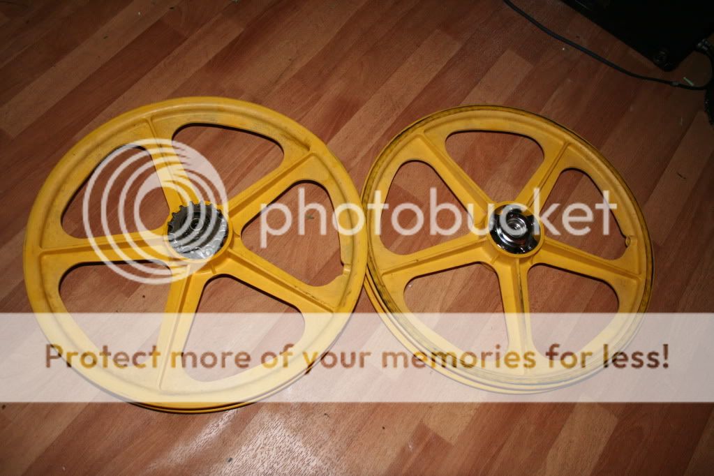

I have gathered all it takes and am following this step by step on a rare set of yellow tuff IIs I will post piccys when done big_smile erm.... thats if it goes well....you may never here from me again!
#15 2011-07-22 11:22am
skywayman
From: Banstead, Surrey. U.K
Signed up: 2010-02-11
Posts: 50
Re: Restoring Skyway Tuff wheels (bleaching and dyeing)
I have finished them!!!! Have a look at the difference!!! I am well chuffed wi the outcome. Scrubbed and bleached and then dyed.... Regrease and away I go....woooo hoooooo Cost £20 to do including a £15 tub!!!!
