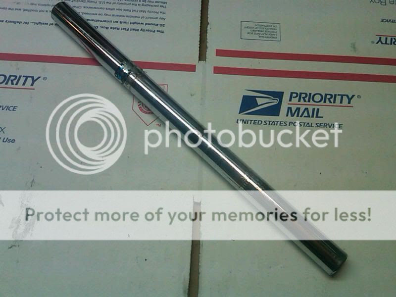

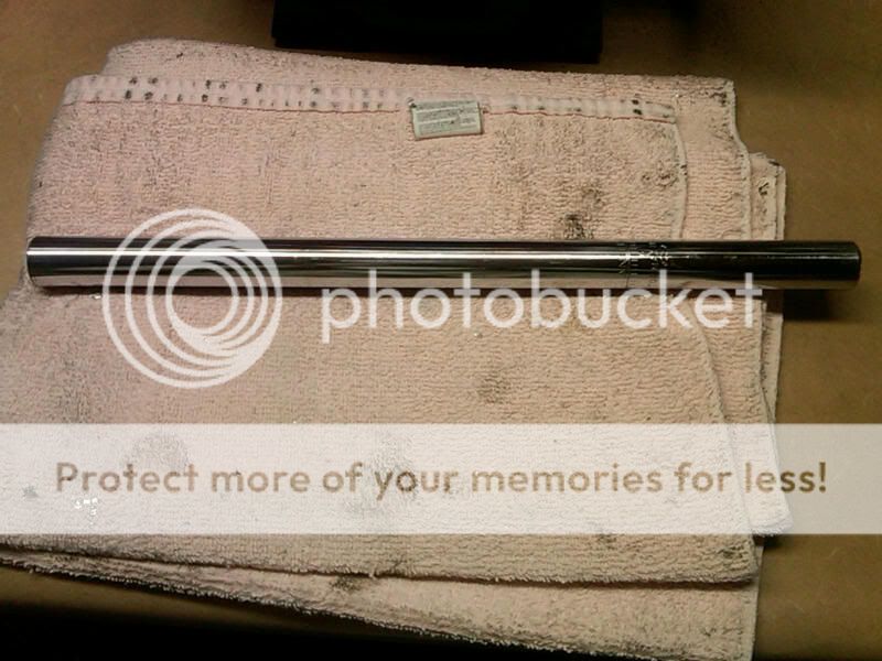

Here is a seat post that had some good wear and tear plus some zig zag marks I made when pulling it out.
http://i98.photobucket.com/albums/l258/GHS_Wired/BMX_Museum_Posts/RU_SlashFS_Pro360_12.jpg
I took it to my soft buffing wheel with Ryobi grade H polishing rouge.  This is the final grade polishing compound in their line.
http://i98.photobucket.com/albums/l258/GHS_Wired/BMX_Museum_Posts/RU_SlashFS_Pro360_53.jpg
After about 3 minutes I could see the marks starting to come off.
http://i98.photobucket.com/albums/l258/GHS_Wired/BMX_Museum_Posts/RU_SlashFS_Pro360_52.jpg
After about ten minutes I had most of the marks completely gone.
http://i98.photobucket.com/albums/l258/GHS_Wired/BMX_Museum_Posts/RU_SlashFS_Pro360_58.jpg

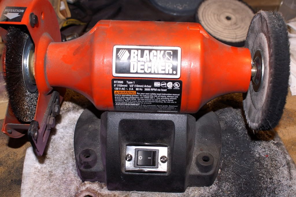

Childude wrote:
what is the best recommendation if I only want to use it to polish? a 1/2hp?
I can't really recommend one as this is the only one I've ever owned.
http://i98.photobucket.com/albums/l258/GHS_Wired/BMX_Museum_Posts/Mirra_540_26.jpg

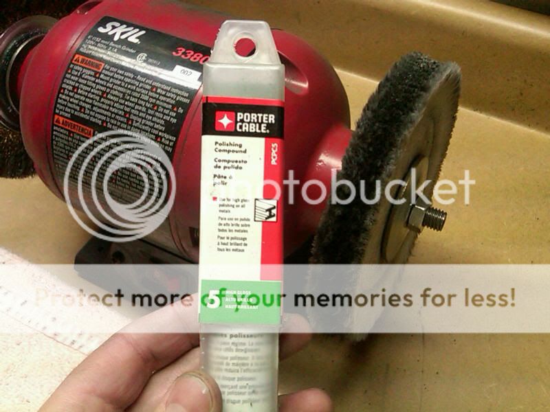

Myth confirmed!  big_smile  I wanted to try it out on something, so I grabbed a rider condition Anlun stem from the parts box.  Not the best before pics, but it's all I had.  There were a couple of fairly deep horizontal scratches, not the normal zig-zags.  You can see one of them right below the Haro sticker, and another about 1/2 way up the post.  They're not completely gone, but they are much fainter.  I think the scratches may have gone through the chrome, and I didn't want to take off any chrome, just make it look a little more presentable.  Looks almost perfect from a couple feet away.  Good stuff:
Before:
http://i784.photobucket.com/albums/yy124/jlewiscpa/Reference/Anlun1.jpg
http://i784.photobucket.com/albums/yy124/jlewiscpa/Reference/anlun2.jpg
The Set-Up:
http://i784.photobucket.com/albums/yy124/jlewiscpa/Reference/IMG00646-20110122-2033.jpg
After (I didn't do below the minimum insertion line):
Some weird reflections in the after photo, but take my word that it looks pretty damn nice!
http://i784.photobucket.com/albums/yy124/jlewiscpa/Reference/IMG00645-20110122-2032.jpg
