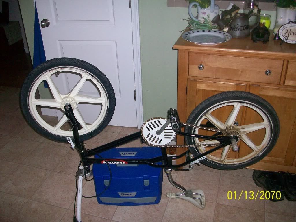

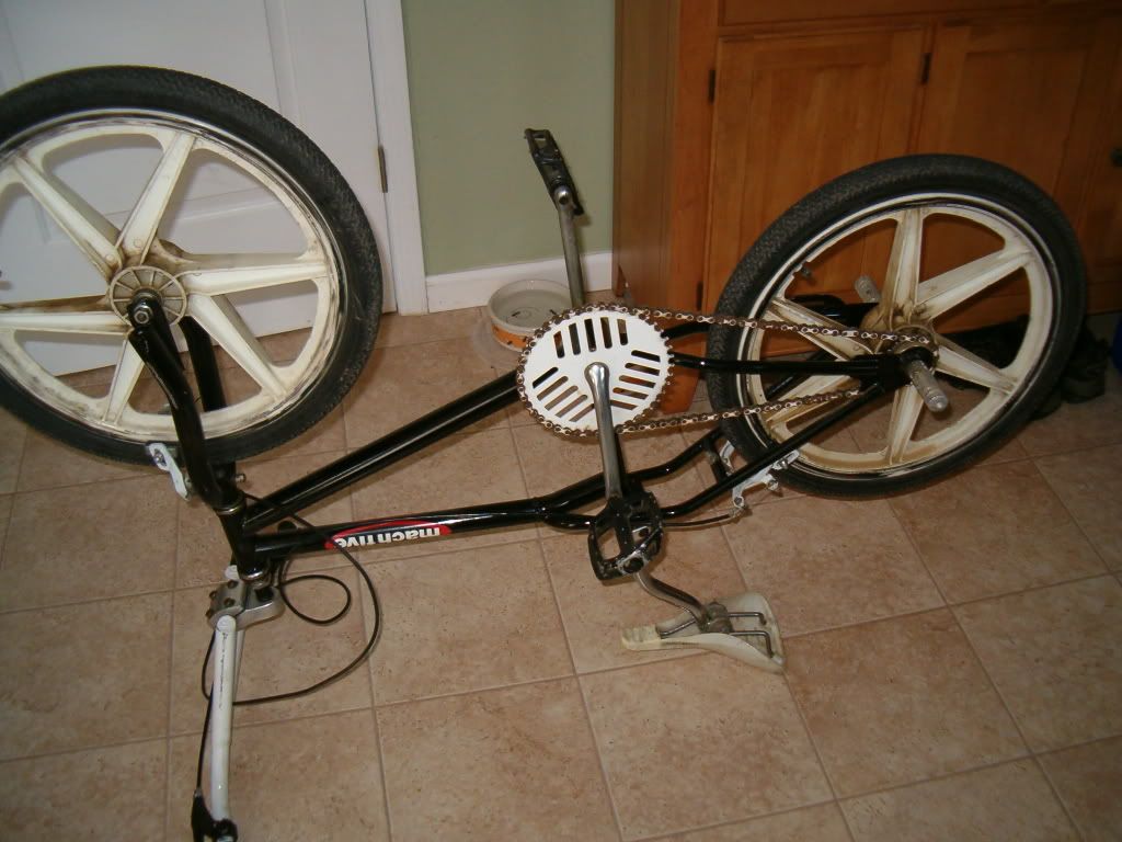

dont want to bleach your mags and wait all that time, this mag was done (both sides) in about 25-30 minutes
here are my weapons:
-soft scrub
-scrub brush
-tooth brush (for tight areas)
-scotch brite (the non metal ones)
-razor blade
http://img109.imageshack.us/img109/4681/001za.jpg
Dirty OGK GT Performer mag with plenty of brake rub
http://img694.imageshack.us/img694/5034/002is.jpg
put soft scrub on one of the scotch brite pads...again these are the plastic ones not metal, then procede to scrub the hell out of the mag rinsing with hot water, alternate the scrub brush too if you wish....may take a few rounds
http://img697.imageshack.us/img697/3570/003pgf.jpg
be sure to use the tooth brush loaded with soft scrub for the tight areas the other scrubbers cant get to, then rinse thoroughly
http://img697.imageshack.us/img697/4537/005xu.jpg
now here is the quick fix to those harsh brake rub marks....screw sanding!!! take a razor blade at a 90 degree angle and just scrape back and forth, it gets rid of the brake rub extremely quick! fastest answer i have found
http://img696.imageshack.us/img696/9637/006kp.jpg
http://img121.imageshack.us/img121/4438/007an.jpg
http://img12.imageshack.us/img12/3189/008hc.jpg
havent tried it on colored mags yet, but once i get a set with brake rub i will do it for sure and update this smile

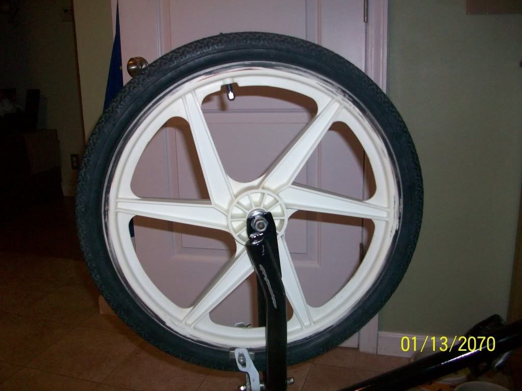

thanks bmxbrackett for the imfo.Dyno-Mike have you tryed simple green on your mags yet I have and here is some pics.Thanks for the brake rum imfo.thanks mike
before
http://i758.photobucket.com/albums/xx228/michellemike3730/HPIM1310.jpg
after
http://i758.photobucket.com/albums/xx228/michellemike3730/100_1798.jpg
here is a close up of the mag
http://i758.photobucket.com/albums/xx228/michellemike3730/100_1799.jpg
