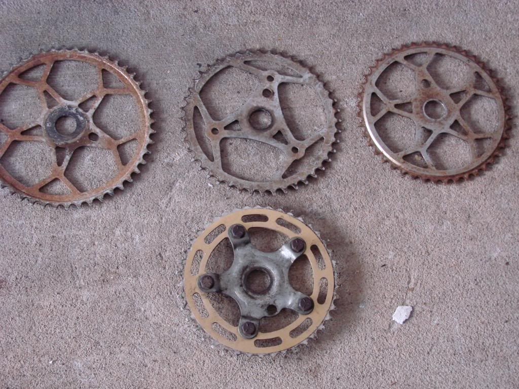

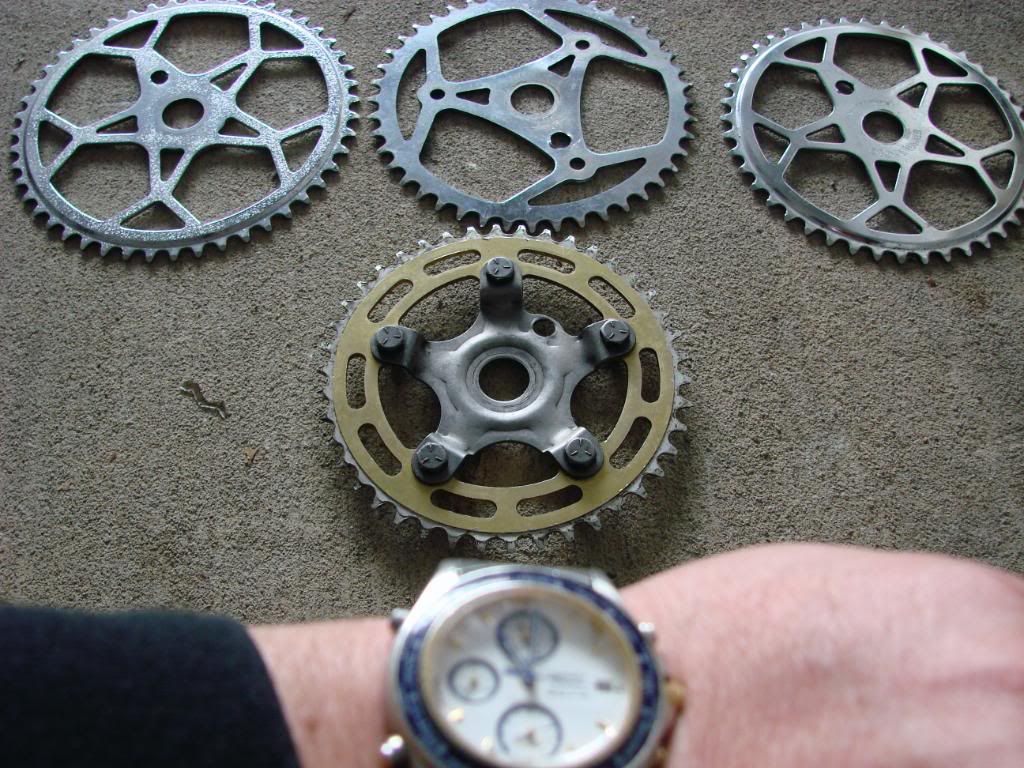

Step 3): Grab a few rusty sprockets in varying degrees of "rustification" tongue
http://i253.photobucket.com/albums/hh73/mongoosedrummer/DSC06867.jpg

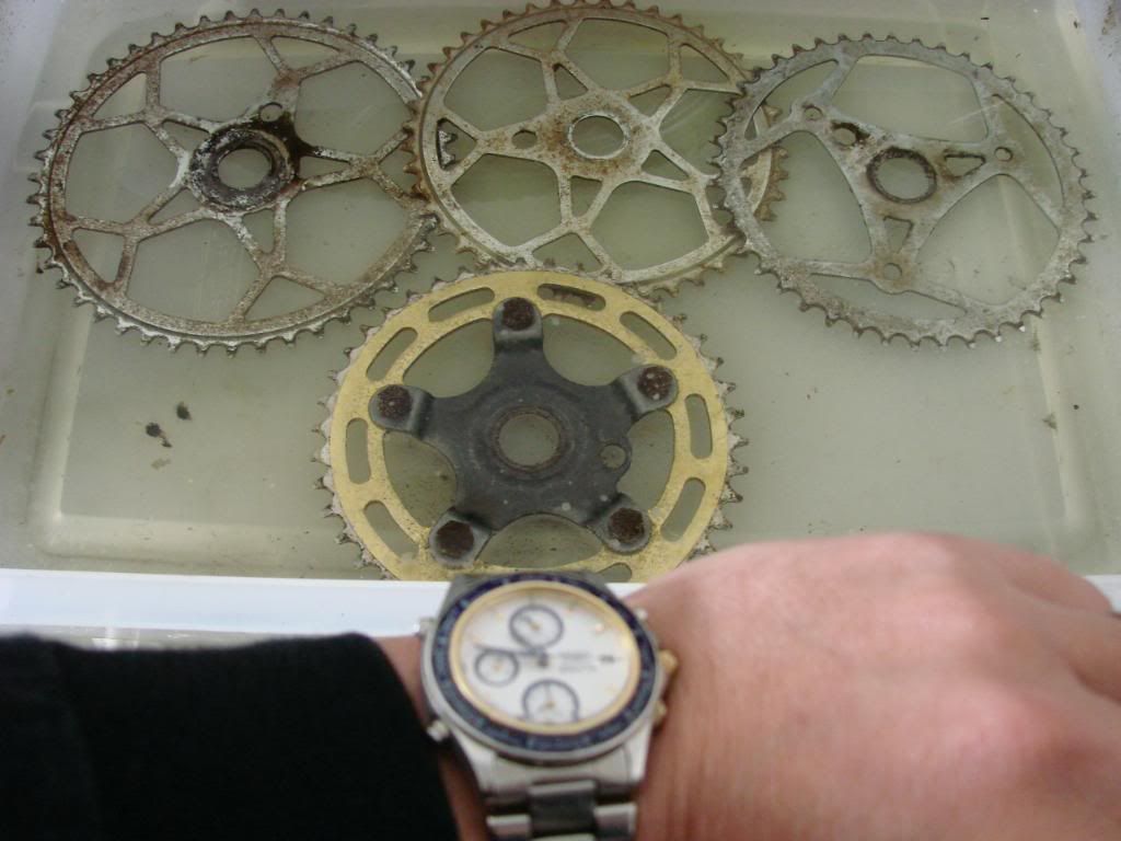

Step 4): Mix the CAP and Water
http://i253.photobucket.com/albums/hh73/mongoosedrummer/DSC06870.jpg
http://i253.photobucket.com/albums/hh73/mongoosedrummer/DSC06872.jpg
http://i253.photobucket.com/albums/hh73/mongoosedrummer/DSC06873.jpg

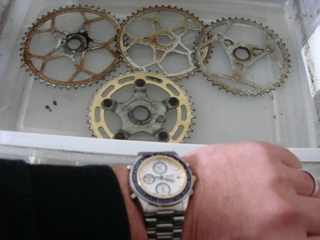

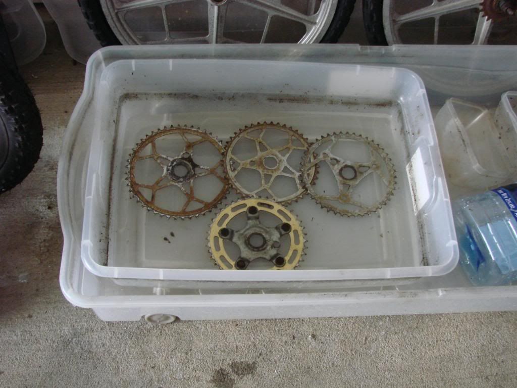

Step 5): Drop in the sprockets
http://i253.photobucket.com/albums/hh73/mongoosedrummer/DSC06874.jpg
Step 6): Note the time (3:45pm) and come back and check after around 24 hours (meaning tomorrow, as I just did this a half hour ago)
http://i253.photobucket.com/albums/hh73/mongoosedrummer/DSC06876.jpg

OK... I'm back. I just completed the process. It was not quite 24 hours. It was more like 19 hours. Anyhow, it was a mild bath and probably would have been done in less time if it had been a bit stronger.
My ratio was 6 ounces of CAP to 1 Gallon of water. I believe this is approximately a 22/1 ratio. Deme could probably pinpoint this for sure.
I would most likely use 8 ounces of CAP per 1 Gallon of water next time. Just to speed things up a little...
Last steps...
Step 7): Check the time - 10:45am Roughly 19 hours... Looks ready.
http://i253.photobucket.com/albums/hh73/mongoosedrummer/DSC06877.jpg
Step 8): Light scrub with with a non scratch pad (half and half shot here)

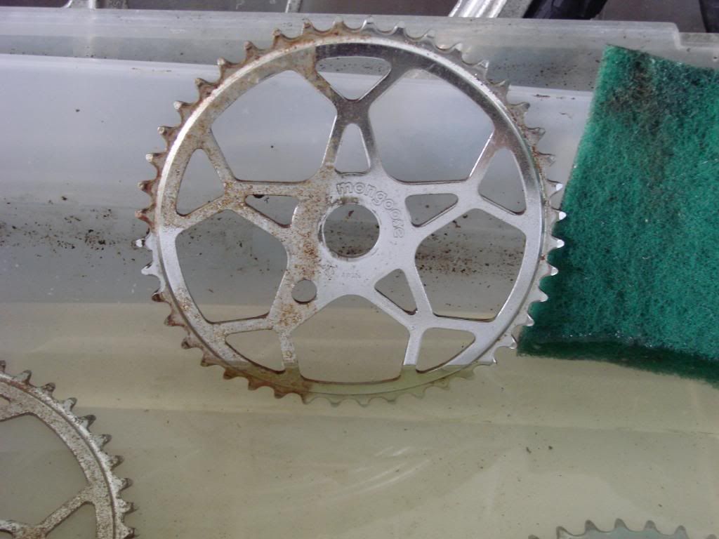

http://i253.photobucket.com/albums/hh73/mongoosedrummer/DSC06878.jpg
Step 9): Admire the transformation! tongue Total time to clean off and dry these sprockets after the bath, under 10 minutes...
http://i253.photobucket.com/albums/hh73/mongoosedrummer/DSC06881.jpg
To take them to the next level, you could just do some light polishing with Mothers to make them really pop.

I forgot to add the final "before and after" shots:
Before:
http://i253.photobucket.com/albums/hh73/mongoosedrummer/DSC06868.jpg
After:
http://i253.photobucket.com/albums/hh73/mongoosedrummer/DSC06880.jpg

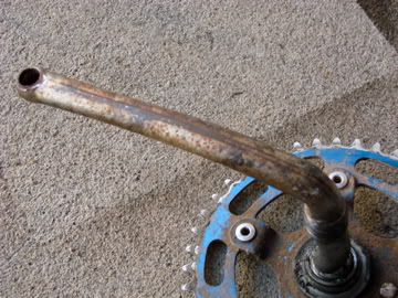

I think I seen somewhere you used aluminum foil for light rust on chrome, I tried it on an old frame and it worked well, even gave it a shine.
SHOOTS, BRAH!!

Yeah, the Aluminum Foil thing is pretty cool. I used some light Canola oil with it, but I've heard Coke or Pepsi works really well too. Probably because of the acids. As long as there is some moisture being used with the Aluminum Foil, it seems to really work well. The light oil seemed to leave a nice shine for me.
After some research about it, I found out the reason why it works:
"Aluminium has a higher reduction potential than the iron in steel, which may help transfer oxygen atoms from the iron to the aluminium. The aluminium foil is softer than steel and will not scratch it, as steel wool will, but as the aluminium oxidizes, the aluminium oxide produced becomes a fine metal polishing compound."
I found the old photos of that demonstration which took about 5 minutes. Here they are:
http://i253.photobucket.com/albums/hh73/mongoosedrummer/DSC05736.jpg
http://i253.photobucket.com/albums/hh73/mongoosedrummer/DSC05737.jpg
http://i253.photobucket.com/albums/hh73/mongoosedrummer/DSC05739.jpg
http://i253.photobucket.com/albums/hh73/mongoosedrummer/DSC05742.jpg

Yeah, you actually have to scrub with the foil... It'll take a few "bunchs". Don't forget you need a liquid of some kind to get the process working. I use a little Canola oil, but I've heard that using Coke or Pepsi works well too! Seriously. smile

I'm a little late in this thread, but I have a related question. If I've gotten a little bit of milky appearance from soaking in vinegar, even though I'm not finished removing rust, might soaking my dropouts in CAP take the milky appearance off as well as the rust? Can I get a "do over" lol?
#25 2009-04-17 7:32pm
mongoosedrummer
From: Twomey, TN
Registered: 2008-01-02
Posts: 785
Re: Citric Acid Powder (CAP) Rust Removal Demonstration
It might. I've never tried to rectify that problem with a CAP bath. I can't see why it wouldn't hurt to try.
I've recently been hearing about discoloration problems from OA and Vinegar baths... You're not the first to have this issue.
It has yet to happen to me with CAP. I've soaked entire dirty Motomags, all kinds of forks, frames, cranks, bars, full pedals and even grips. Never had that problem...
A friend of mine had a slight discoloration from vinegar on his chrome frame. I believe it came out with some polishing with Mothers.
Hope that helps. smile
