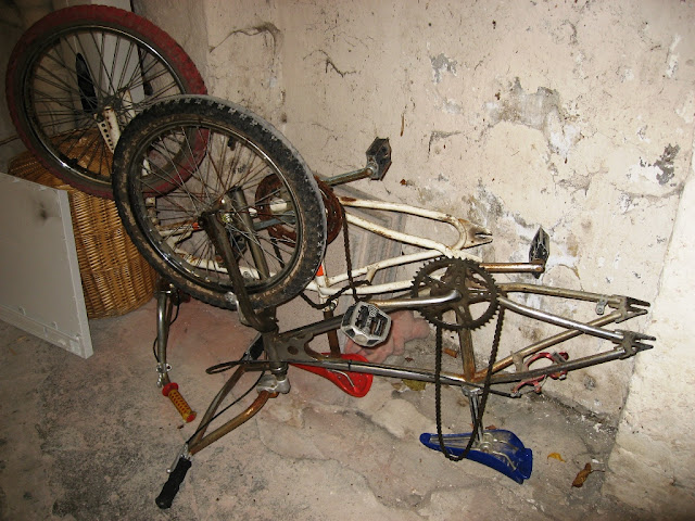

Hi,
it is incredible.. but i have the same bike in bad conditions...
http://lh4.ggpht.com/_y0VZudD2UDo/SVjEAnXxknI/AAAAAAAAAGo/qAEq5AZ1N9c/s640/IMG_8548.JPG
i`m going to restore it soon...  big_smile
