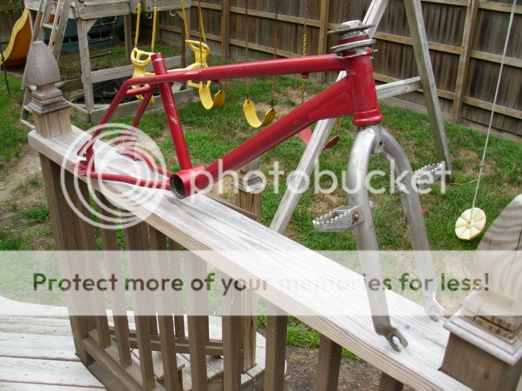

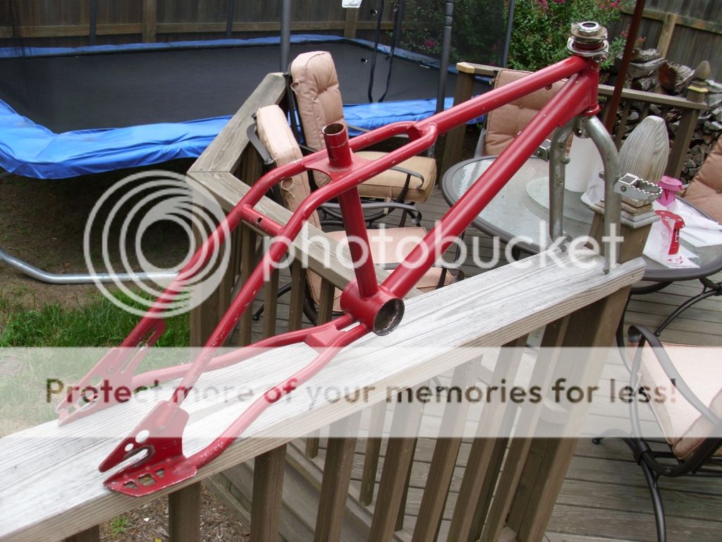

This was a Sport which I recently sold.  It had "8512" as the S/N.  I'm not a Haro expert, so I don't know much.  I did always wonder why they had 3 models which were so similar?  I guess they really had enough sales to permit splitting the line:
http://i967.photobucket.com/albums/ae154/troynlori/86%20Haro%20Sport/DSCI1388_zpsab96114b.jpg
http://i967.photobucket.com/albums/ae154/troynlori/86%20Haro%20Sport/DSCI1390_zpsc8976f30.jpg

That's a perfect example of a 86 Sport (made in late 85) with high fork peg inserts and the shallower gusset. There will be a shiny coat of chrome under that paint.
The three bike line up was intended to appeal to flatland riders (Master with 18.5" twin top tubes), vert riders - the Sport, slacker head angle, 19.5 Top tube , and the FST (18.5" Top tube an slack head angle) was aimed at the all rounders and entry level market kids who wouldn't justify, or couldn't afford a Master or Sport.

Thank you....didn't realize the different geometry...

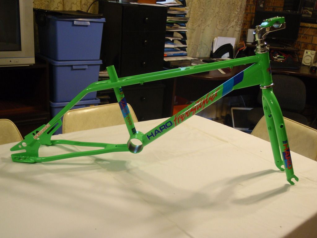

My MARCH 85 Master no knurling on the chainstays and the cable guides are on the side of the top tubes not under.........wink
http://i1129.photobucket.com/albums/m520/savic666/P1060010.jpg
http://i1129.photobucket.com/albums/m520/savic666/P1060001-1.jpg
