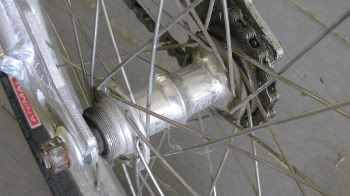

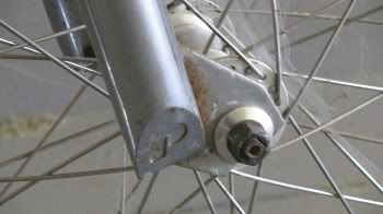

I picked up this early aluminum Powerlite in San Jose, CA.  The guy who I bought if off of said that he got it in 1995 from a friend who used to ride for GT/Powerlite and had it custom made.  I got the bike in rough shape, but it came with a Powerlite fork, stem, and seat post clamp, GT Power Series cranks (175mm long), GT Overdrive chainwheel (46T), Araya Super 7X rims (chrome, but very pitted) on GT Mohawk hubs (36H, flip-flop rear), ACS Claws freewheel (16T), a Narrow KMC Z-chain, an original Dia-Compe Steel Aheadset, cantilever brakes, and GT pedals, seat, and seat post.  The previous owner recently had the grips and tires replaced (Redline grips and Animal GLH tires).

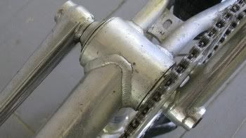

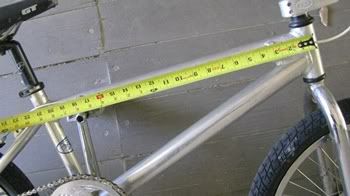

This particular frame has no serial number.  The only Powerlite markings on this frame are stamped Powerlite 'P' logos on both sides of both rear dropouts.  Other than the top tube lengths, the only difference (that I know of) between the 1994 Pro AL and the 1995 P-61 AL is seen in the head tube welds; the Pro AL has a boxier upper head tube gusset and no lower head tube gusset.  Also, like the '95 P-61 AL frames (see the rear dropouts - http://bmxmuseum.com/forums/viewtopic.php?id=25129), the '94 Pro AL was designed to use 14 mm dropout savers.  In 1995, the Powerlite P-61 AL (sold as a complete bike and also as a f/f kit) replaced the Pro AL frame.  The 1994 Powerlite Pro AL was made from 6061-T6 aluminum, was TIG welded, and had a 20.5" top tube.  The 1995 Powerlite P-61 AL had a 21.0" top tube.
